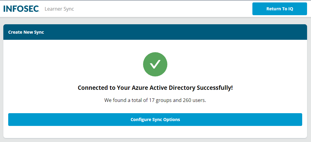

 - After authentication is complete you’ll see a success message listing the number of users and groups in the directory. Click “Configure Sync Options” here.
